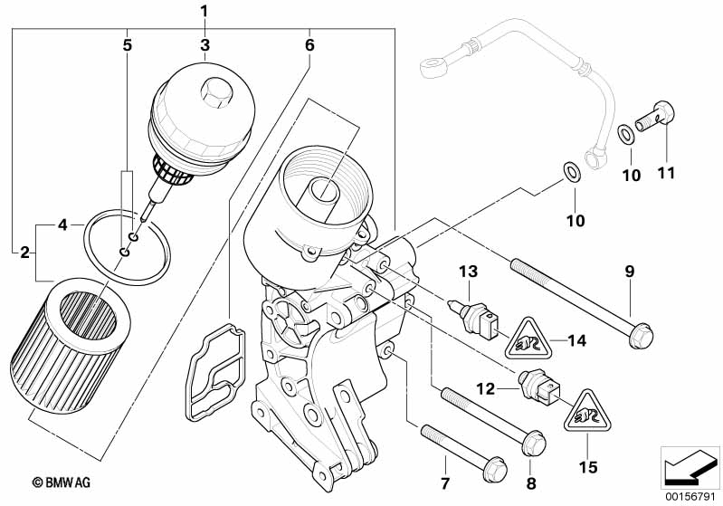

https://www.realoem.com/bmw/enUS/showparts?id=CH32-EUR-09-1998-Z3-BMW-Z3_28&diagId=11_6223
Don't forget to order two of item 5. They don't come in the kit, but should be replaced at the same time as the filter.
It might also be worth emphasising not to change the filter after the sump plug has been replaced. It is best to remove the filter before removing the sump plug, like you did - but emphasise that it is because old oil from the filter housing drains into the sump. If you remove the sump plug, then remove the filter, the oil from the filter housing is unlikely to be properly drained, or will take a very long time to drain.
